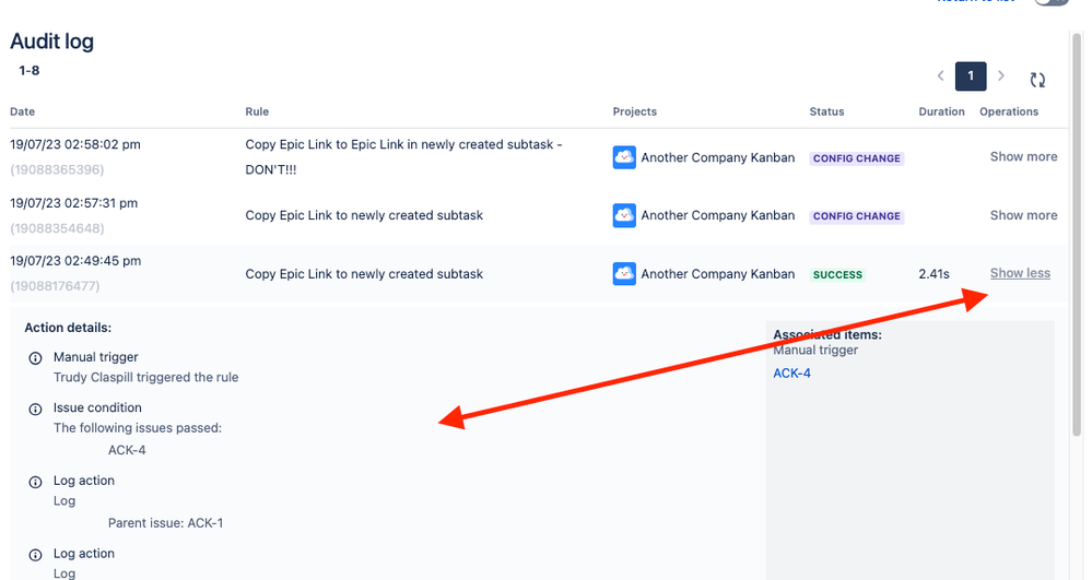

Two things that are very helpful:
1. The Audit Log - Every change and publish of the rule and every execution of the rule will create an entry in the Audit Log. You can expand the individual entries to see the details.
2. Use the Log action to print messages into your Audit Log. You can print plain text and include any smart value that you could use in your rule. I use it to print original values from fields and print out any calculations I'm trying to do, like calculating the number of days between two dates.
