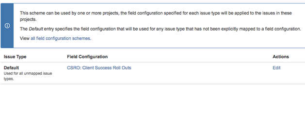

Correct me if I am wrong @Joe Pitt at the following set up under "Feild COnfiguration Schemes" so if I add an issue type Epic and ammend as necessary that will solve my problem?
Yes. I usually have a different field configuration for each issue type in a project. For instance, 'steps to recreate' is needed for bugs, but not for tasks.
Thank so much Joe much appreciated. I did some major changes and then it keeps asking for my mandatory feild on Tasks, driving me bananas.
