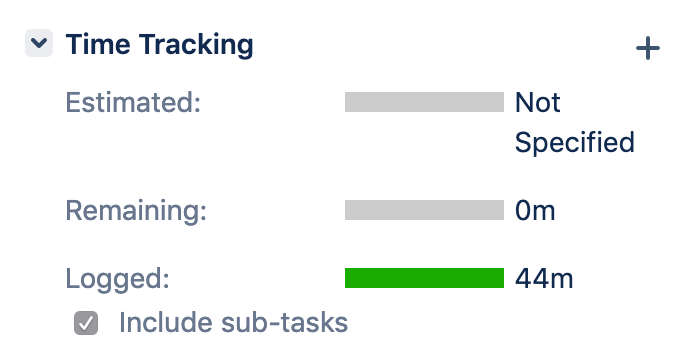

There is a "time loggin" panel in the issue view that shows you all the time logged. It has a tick-box for swapping between "this issue" and "this issue and its sub-tasks".
The panel only appears if the task or sub-tasks have time data on them. My Jira (8.4) does the below. I've got a story with no time-tracking at all, but a sub-task with 44 minutes logged.

When I click the issue and go down to the time logged section, my interface is different from your example image. I have no drop down feature that showcases additional options. I have attached image for reference below:
There's no image attached, but I can say it will look different if you are on Cloud, and even more different if you are using a Next-gen project rather than Classic.
