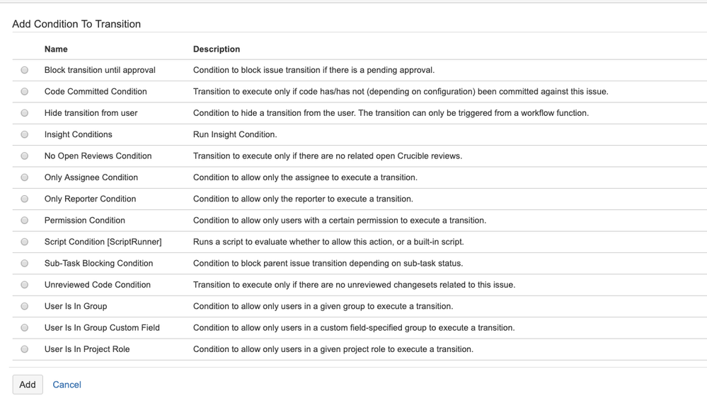

Hi @Ismael Jimoh ,
Thanks for your help. May I know which condition section should I need to use for ? because I tried one before, but It looks not working. Thank you very much : )

Hi @Ismael Jimoh ,
Thank you very much again. However, in your way, only assignee can see the transition but what I want is everyone can see the transition when assignee field is not "Unassigned". My idea is I want to require that someone take ownership before the task can be moved. Do you have any idea about this? Thank you very much!
Thanks for the clarification.
In this case, look at an add-on like:
issue.getAsString("assignee") != "" //Test this as I have not checked it but the logic is thereThese 3 are some of the options that allow you expand what JIRA can do and in this case is necessary as JIRA out of the box cannot fulfil what you described.
