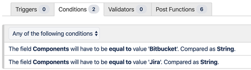

That should be it. I don't have JSU where I currently work, but the condition should work similar to the one on Jira Cloud, here is an example I just created:
In this case the component has to be either Bitbucket or Jira for the transition to be available. Look at the condition setting, is it set to Any of the following conditions or All of the following conditions.
Thank you for answering. I will try String values with quotes.
