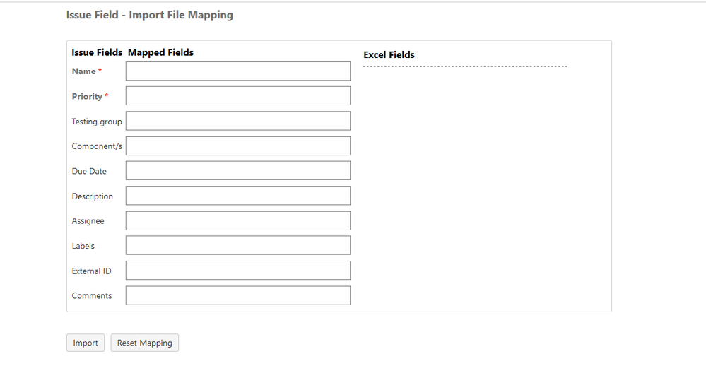

but that is kinda out of the question because we don't have control over the Jira (the 3rd party has). I have checked what fields does importer has available and as you can see bellow there's very little.
zephyr.PNGCan it be done with the Importer instead of that utility? We might be able to ask the 3rd party to make changes to importer settings and I just need to know if it can be done. If not, we would just do it manually.

We can't use the Importer utility becasue we don't have access to the local machine since it's under control of the 3rd party and the Importer which is in Jira doesn't have the fields to import test steps.

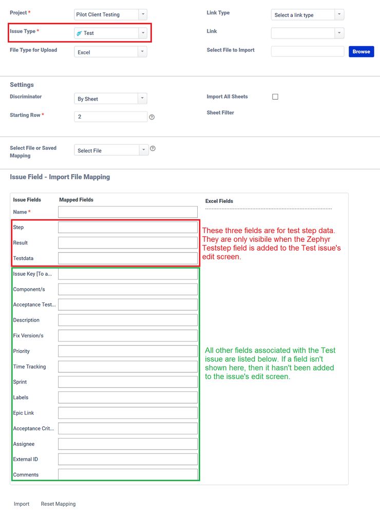

The Importer Utility uses the REST API, so you don't need 'local' access, only network connectivity over ports 8080 and 443. Ask the third party to accommodate this and you're in business.
As for the built-in Importer, it supports all the fields of all the issues within the project you are accessing. If the field isn't shown on the Importer's screen after you connect to a project, then that field hasn't been configured to be visible on the associated issue's edit screen. If you resolve that, the field should be available to you.
You specifically mentioned 'test steps'. The field you need to add is called 'Zephyr Teststep'. If you add that field to the Test issue's edit screen, when you use the Importer to bring data into a Zephyr Test (issue) your Importer screen will show the three test case data fields, as per this screen grab:
