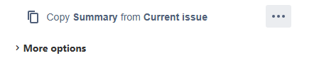

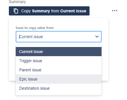

Instead, use just the Edit Issue action in the main line of the automation rule. You can use the COPY FROM option to edit the field and copy the value from the issue's parent Epic.

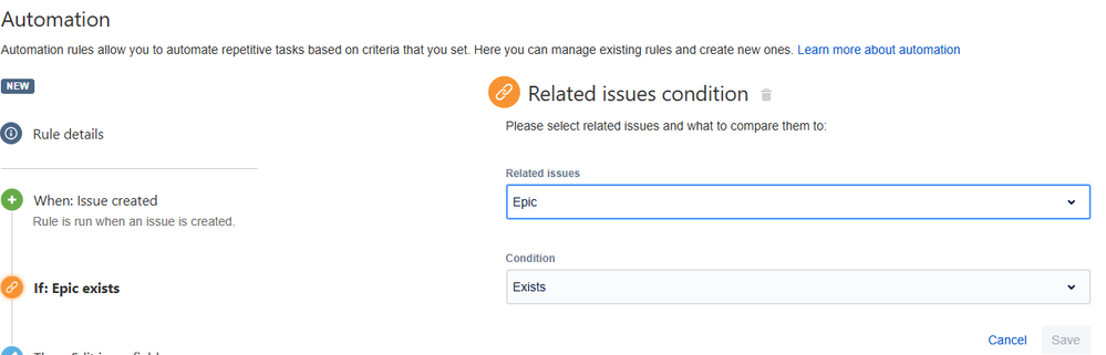

I would also recommend that you add a Condition to your rule, perhaps after the Re-fetch action, to confirm that the triggering issue has an Epic specified:
