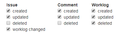

In your Webhook configuration, you have issue-updated checked?

The checkboxes weren't activated because I thought that when "All events" is used I don't have to check the checkboxes.
However, Josh, you were right! I didn't checked them...and that was the problem.
Thank you, Josh! :-))
