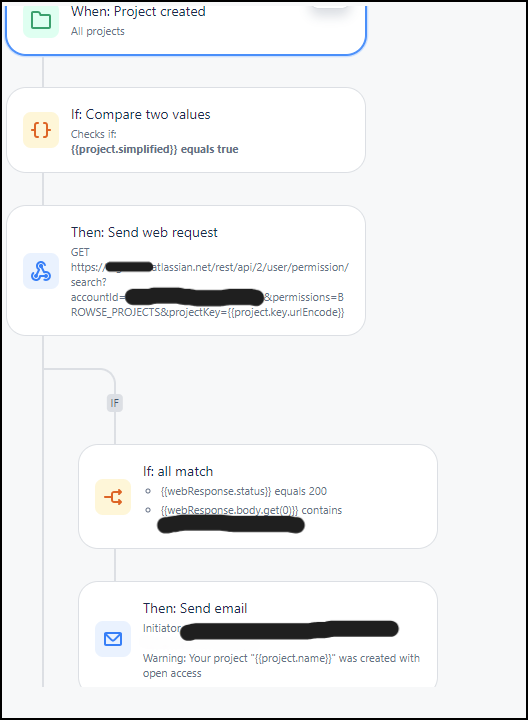

This is how I did it.
Basically it checks if a licensed user that I created (account needs site access and possibly a Jira Software license) specifically for this automation has the browse permissions on a newly created team-managed project.
It seems like "project.simplified" is always true for team-managed projects, so I just used that for the lack of a better indicator but I think you could just remove that if condition completely and it should work.
I did this more than a year ago, so there might be better ways now.

Milos Pavlovic
July 31, 2024
@Hope Man This is great, thank you.
Can you please elaborate on values for accountId and the second webResponce?
I'm having a hard time understanding the logic. Tried a few things, but getting errors.
Thank you very much in advance.
Miloš
Hope Man
July 31, 2024
AccountId is the Account ID of a user that was created just for this automation. The only thing this account has is a Jira Software license.
I'm calling a Jira REST API query in the "Send web request" block to check if this account can browse/view this newly created project (I'm using my own admin account's access token as authentication).
Then I get a response with a code and a body. 200 is code for "ok", which means there were no errors.
Then I I get the body and check if it contains the above accountId.
If yes, then I send an email to the user that created the project (and me as a Jira admin), because it means the project was created with open access settings since somehow a user with only a Jira Software license has the BROWSE_PROJECT permission for this new project (this only happens if the access settings are set to "open" or the account was specifically added to the project's permissions).
It's possible that there are better ways to do this now. Saw a bunch of REST v2 and v3 call candidates that I may or may not have tried when I attempted to create this automation a year or so ago.
