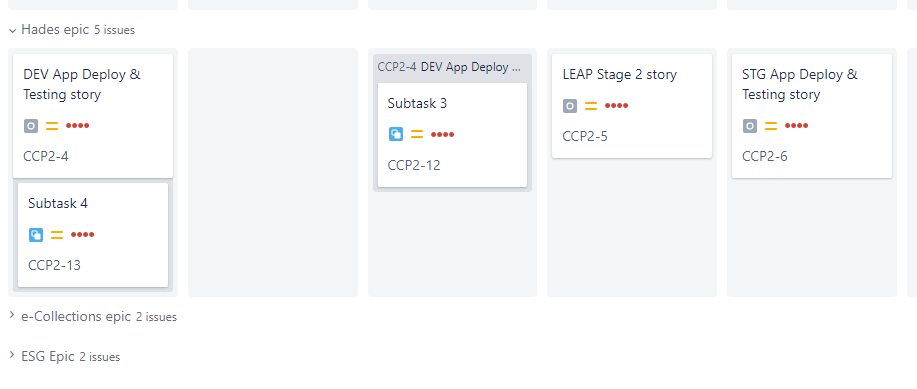

I have a Kanban board that shows work-items grouped by Epics (i.e., Swimlanes are based on Epics) and under an Epic rows I can see stories plus if there are sub-tasks under that story then those too inside the story card.
For the above view my board's filter query is basically "project = projectName" which means the board is showing all the epics but I want to see only a few epics. Is there a way to retain the above view/layout and show only the epics that I would want to see?

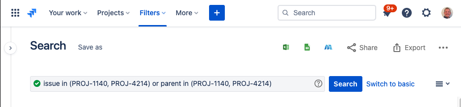

You could try this:
issue in (PROJ-1140, PROJ-4214) or parent in (PROJ-1140, PROJ-4214)
To continue the investigation, can you try this same query in the Advanced Issue Search under the Filters menu, to see if you are getting the results correctly.
That will narrow down whether or not its a board issue.
