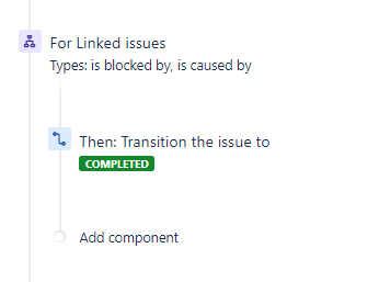

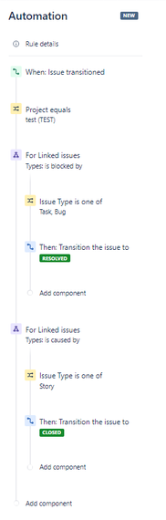

alternatively, if you have different workflows and need to distinguish between the final statuses, you can do it like this:
I agree with @Dirk Ronsmans , but I've already had this picture prepared, when I found out there's his answer , so I decided to post it instead of throw it away :-)

Hi @serge calderara ,
For me the Link Types there would be all the link types that will match. One link can only have a single link type so adding in all the link types that you need should act like a OR
Something like all issues where link type = demands or refer to incident
I am wondering tho if you even need to do this.
You are
1: trigger it on the parent issue when it goes to Done
2: you then check the project, why not just make a project specific rule
3: For linked issues: select an issue type -> why don't you just set the action to move them to completed under this component?
Imo, it will loop through the linked issues and you already check it in the For Linked Issues component.

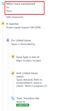

dear @Dirk Ronsmans  my scenario is a bit more complex here is the complete picture :
The trigger issue is as below :

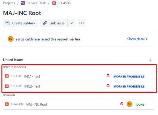

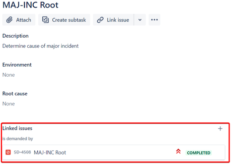

As you can see the first link type is "is demanded by" which then succeed to transition the incident SD-4508 to completed. Then if I open the SD-4508 it displays as below :
As you can see from above my goal is to close also the Refer to Incident issue when trigger issue SWD-233 is set to DONE.
But as you can see it does not work ., status remains WORK IN PROGRESS L2

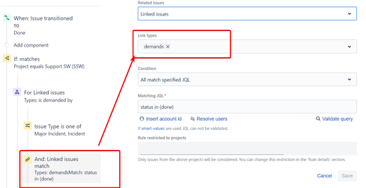

is below my rule :
Seems that the condition in red square above is not logically apply teh condition.
Any idea ?
regards

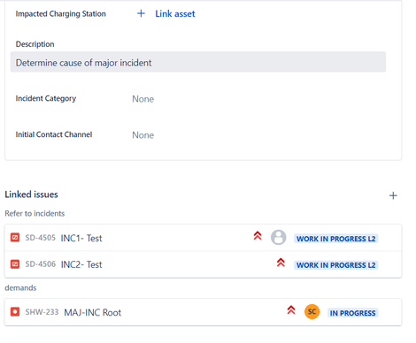

Dear @Dirk Ronsmans in fact it execute only once the For Linked issue Action and I need to execute that part also for incident type
The signification of the check box you mentionned is wierd because it says that it allows other rules to trigger this rule BUT in fact I do not have other rule which trigger that rule...
I  check it and but result is the same it handle only the linked issue of the issue which trig the rule
Parent issue (SHW-233) : trig the rule when set to DONE
         Linked issue type : Demand by => major incident (SD-4508) =Set to COMPLETE
Issue SD-4508
        Linked issue type : Refer to incident=> incident (SD-4505,SD-4506) = Remains open ???
Any idea, does it mean I need to setup a separate rule to handle issue SD-4508
regards

Well it also means the rule can trigger itself again.
as you have multiple levels that’s why I was thinking about recursion
serge calderara
January 22, 2021
Yes but if the whole rule was suppose to trigger a second time it will not trig because of the first rule condition which is triggered only if issue transition to DONE, which has been already done, so rule will not trig
Any idea how to solve ?

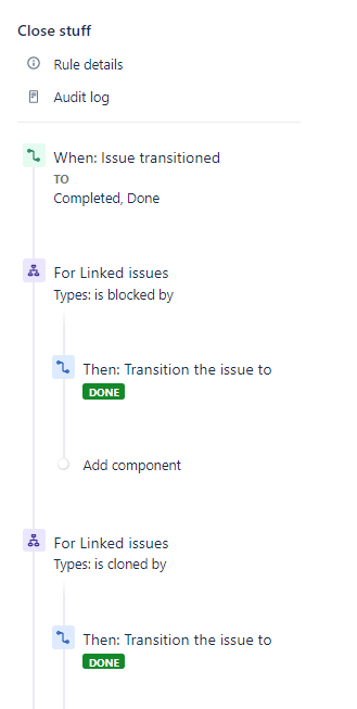

Hey @serge calderara ,
I've made a small test in my environment and I think this might work.. or at least as a proof of concept.
Since it is one rule you'll need to put it as a global rule. the rule itself will re-trigger itself too so make sure to put that checkbox.
i've added both transition statusses as the trigger, "completed" and "done" and then in my For linked issues I verify the link type and tell the issue what status to transition too.
Since your issues are in multiple projects you won't be able to do it as project specific rules. However if you specify what link type you want  it to happen for this should be the way to go.
