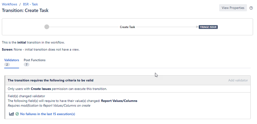

@Payne I've been attempting ScriptRunner's validator to no avail on my Create Task transition just for test purposes, and no matter which way I go to access the workflows, I can't get the Field(s) Changed Validator to work properly. Every time I get to the screen to select which field needs to be validated, it says there are no fields available.
Jake McCoy July 27, 2021

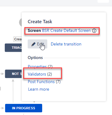

I just figured out my issue. My team's transitions were not set up to use screens, they were essentially just a barebones transition. Once I set up our "Create Task" transition to use the Create Screen, everything worked using our Business Justification field as a test case. Thank you @Payne

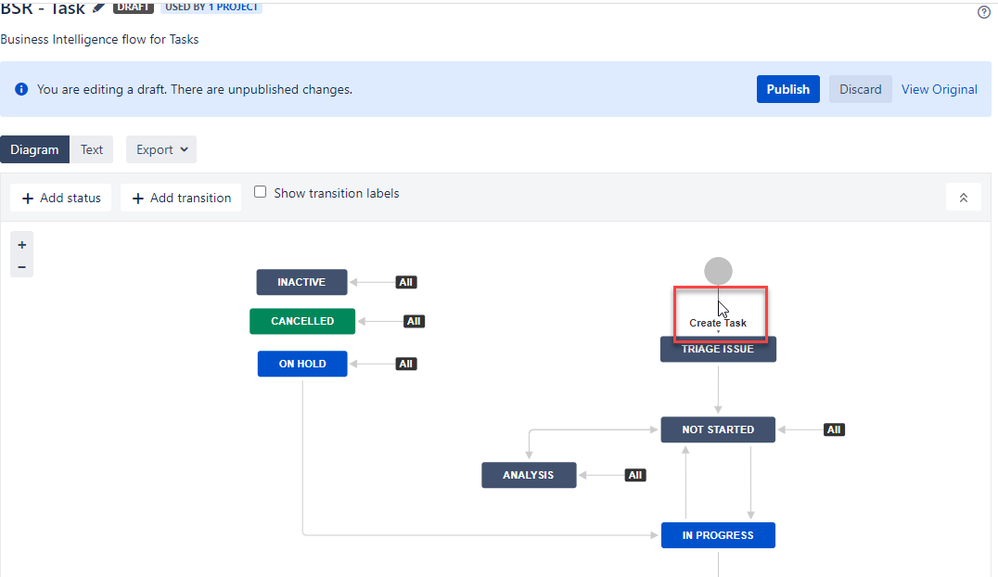

@Ahmad Al-Shaibani it's important to note that my team paid for ScriptRunner and is using the out-of-the-box validator seen in the screenshot. On your "Create Task" or story, or whatever Transition, you need to be sure the Create transition is associated with a Create Screen otherwise your validator will not be able to find any fields to validate.
