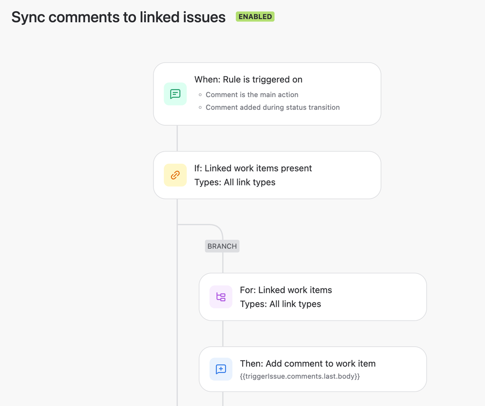

To give you a sample rule:
It is not exactly what you need, but the structure is quite relevant.
Suppose you want to add a comment to linked work items when the status of an item changes, all you would need to do is:

Second option is to use the automation rule where the setup would look like something like this:
