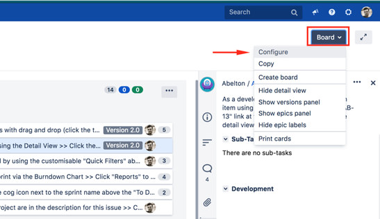

You can add field to backlog car layout by bringing board configuration:
then go to card layout and add your fields to backlog card layout:
You can also add a quick link to any pages (include issue navigator) from your board view, via this button:

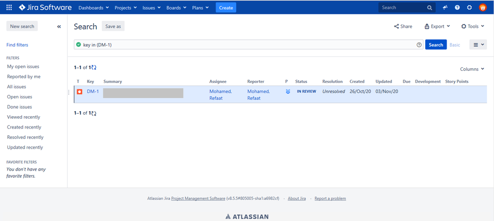

Although the issue navigator looks exactly as I want it:

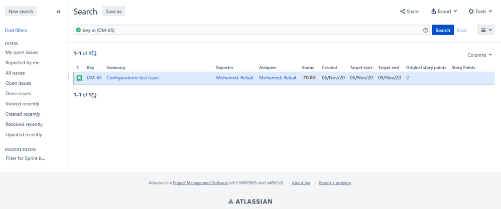

As you see in the pictures, The status added to your backlog view. Please add a value for the DM-1 story point, then check it again on your backlog. The story point is a built-in Jira field and It already exists on your backlog if it has value

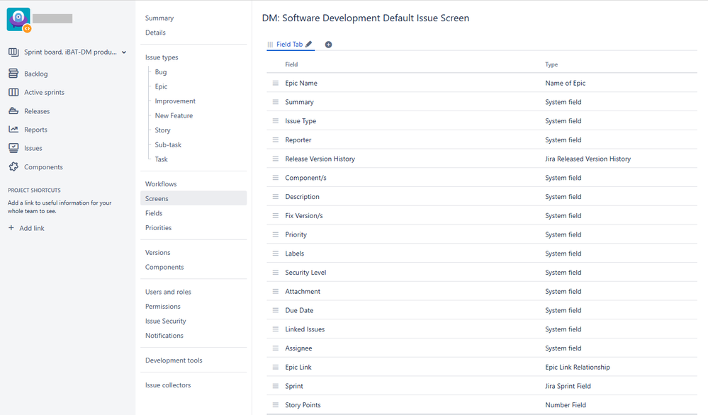

I configured my screen as follows:
As can be seen, Story Points field is added.

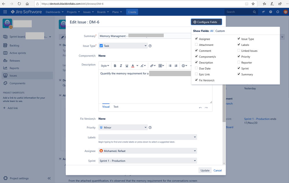

However, when editing the issue, the Story Points does not show up.
It may be because you use different screens for the Edit screen. Check the project Screen Scheme to be sure you add story point to all appropriate screens

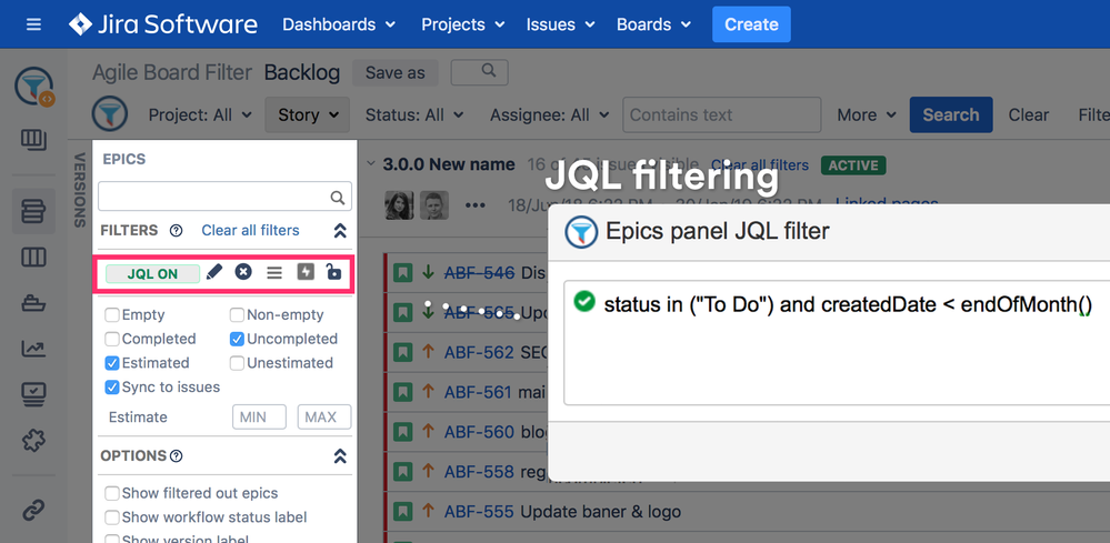

As far as I know, You cant change the backlog layout to looks like the issue navigator. If you need more filtering capabilities via backlog checkout Agile Tools & Filters for Jira Software plugin, Maybe it works.
