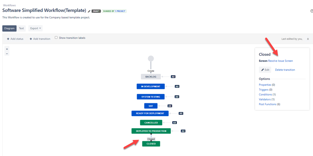

  • Edited the workflow. Added Resolve issue screen to the Closed Transition.

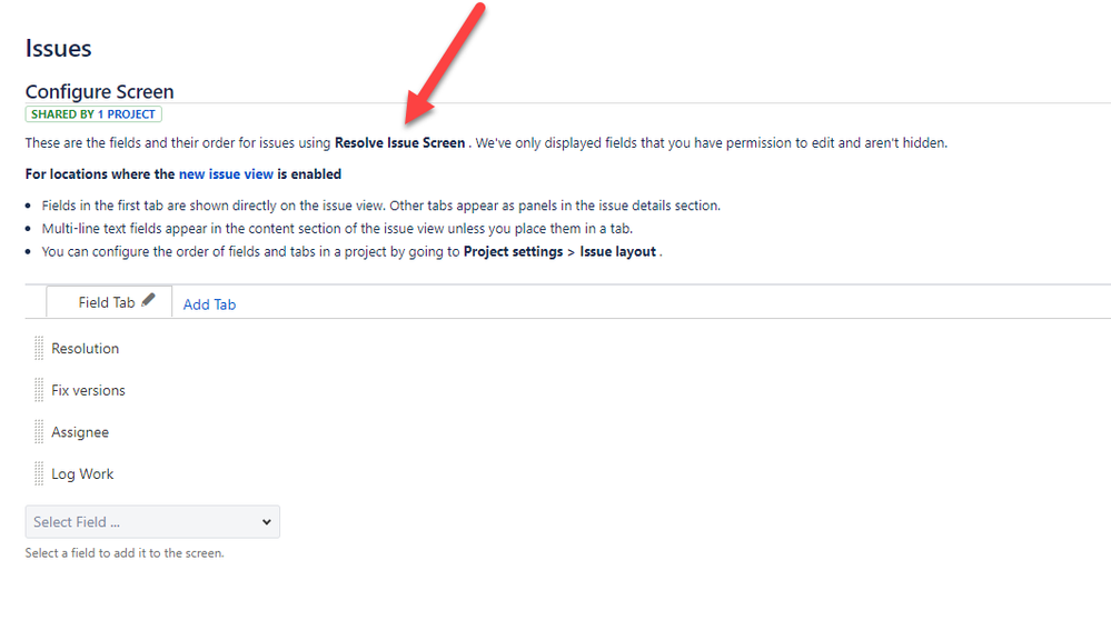

  • Resolve issue screen has 'Resolution' field.

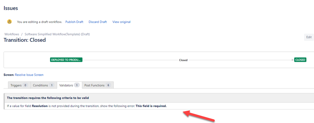

  • Tried by making the Resolution mandatory on the Closed transition by using validators.
All these are not making the Resolution field mandatory.

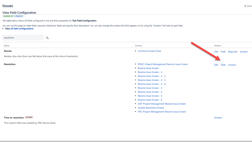

Also, cannot find how to make the field mandatory from the field configuration used by the project. Required - button is missing
