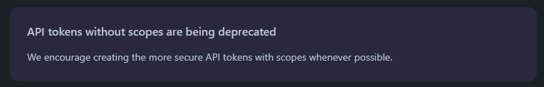

Recently ran into the same issue. I presume it doesn't work because the scopes are only for OAuth 2.0 authentication and wont work with basic auth. image.png
As unscoped API tokens are already deprecated i wonder if basic auth for API calls will also be deprecated in favor of only supporting OAuth 2.0 authentication in the future.

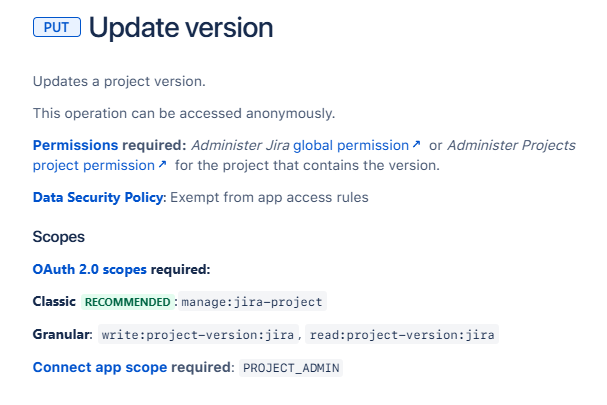

I saw that you tried granular scopes such as delete:project-version:jira , read:project-version:jira and write:project-version:jira. It is just a guess, but have you tried using the classic manage:jira-project scope? I found some information in this Update version.
It is just a guess, I'm interested to hear what others have to say!
