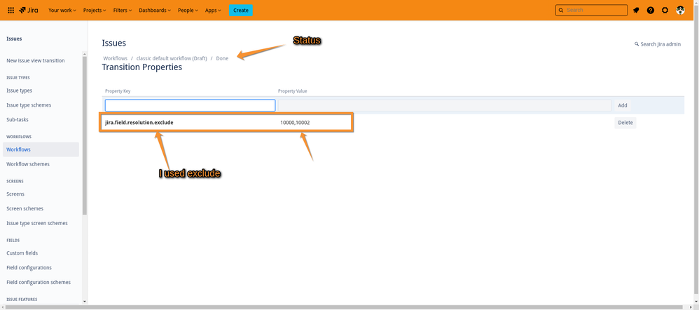

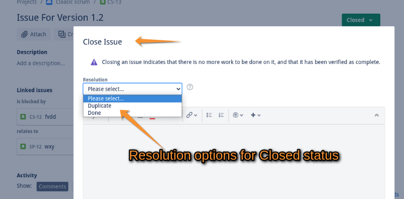

Hi @Tammy Cohn You can achieve this using the workflow properties as shown below
For transitions to Closed status add the property to include the resolutions ID's which you want to display on the transition screen,
For transition to Done status you can either exclude the once added for Closed status or add the new values which you want
On both the statuses you can you same transition screen which has resolution screen present on it.
Hope this will help
