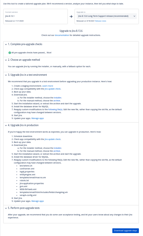

- Not sure, if plan your upgrade check is available for 7.3 version or not but still you can confirm from below link
https://<jira-base-url>/plugins/servlet/troubleshooting/pre-upgrade/
This will provide you the details report about upgrade steps

- Follow the below document links for preparing the upgrade
https://confluence.atlassian.com/adminjiraserver0813/preparing-for-the-upgrade-1027137569.html
https://confluence.atlassian.com/adminjiraserver0813/upgrade-checklist-1027137561.html
