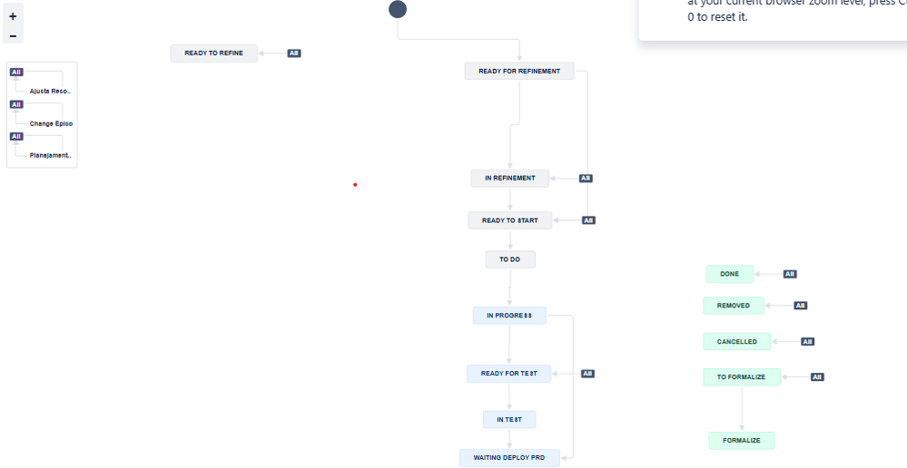

Hello @Viviane da Silva Moreira
Can you provide a screen image of your workflow?
Without that I suspect that you have more than one transition leading to the Cancelled status, and the solution is to remove the other transition(s) to that status so that the only one that remains in the one you named Change.

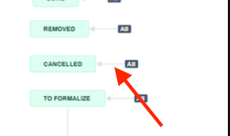

Hello Viviane,
When you have the workflow diagram open in Edit mode and click on a transition arrow you will get a pop-up showing the name of the transition.
Which of the transitions in the diagram is the one named "Change" that supports the transition correctly?
What is the name of the transition pointed to be the red arrow in this image?
If this is not the transition named "Change" and is instead the one named "Cancelled" then it is this transition that is showing up in the transition options, and it would need to be removed.
