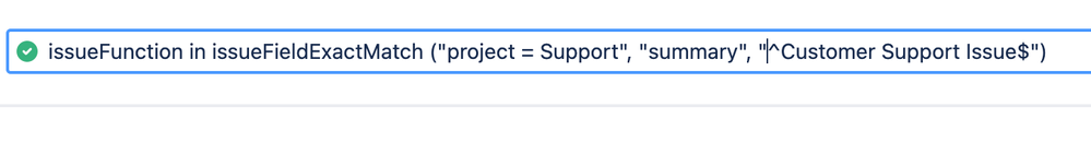

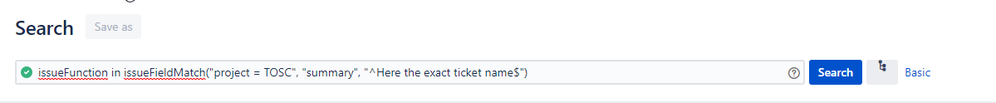

Hi @Joshua Hopkins ,
Yes see my screenshot :
In my case i use it in Jira Automation and it's working fine.

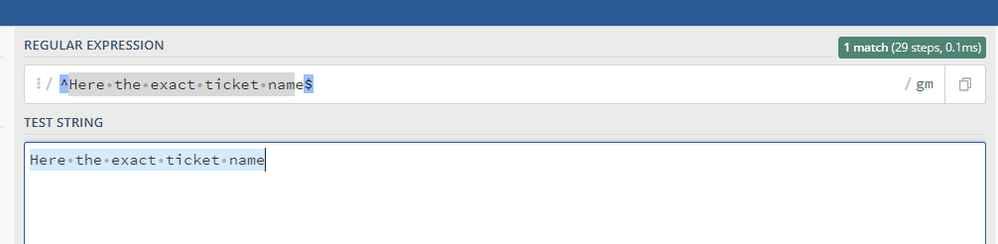

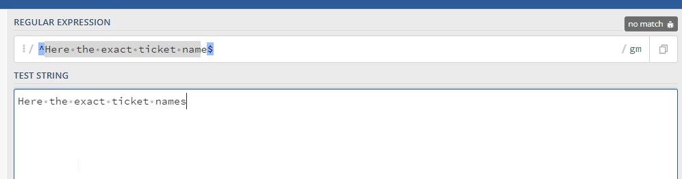

To help you, you can use the website https://regex101.com/ to construct your regex if you need more than an exact match. To have an exact match, just put your text between ^and $ as shown but with regex101.com you can construct more precise.
Is it clear for you?

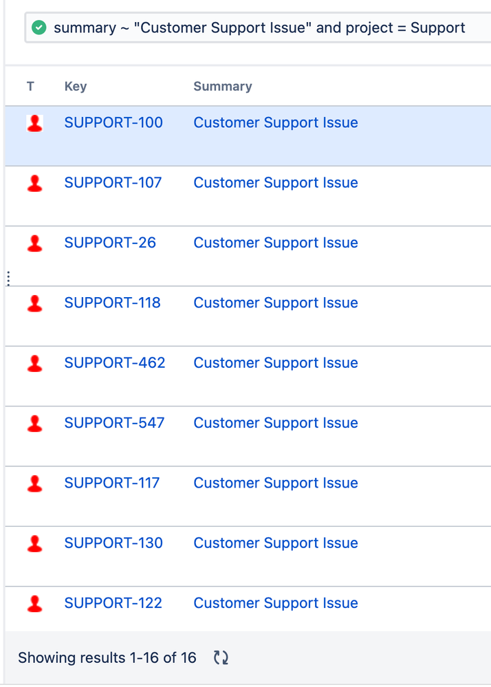

Can someone help me understand why this query returns 16 tickets (14 of which are an exact match), but the below scriptrunner query does not work?
