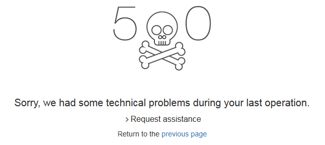

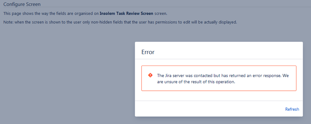

For information on the files, the first image is my screen that i want to remove (with the delete button active), the second one is the message i receive when i try to delete it and the last one is what happens when i try to configure it.
Martin.
PS: this is the message i get when i try to delete the screen in Jira : (i can't post the complete error message in here)
java.lang.NullPointerException
