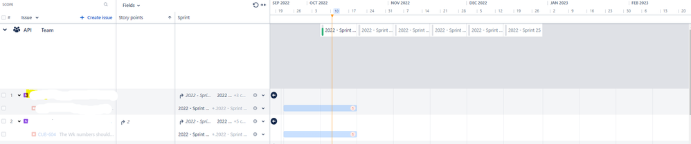

So I am using the plan view and there is a big space that is disturbing me
and all the project are running through one sprint

I thought this was a bug or something, but it seems this is related to your data most likely. In an instance I support I noticed the same thing. It appears that the large grey bar is the area where your sprint capacity is listed. And most likely, in the past you probably had a few concurrent sprints. These are displayed on the timeline below one another.
If you scroll left towards the past, you will most likely be able to locate those sprints. I'm afraid there isn't much you can do about the behaviour of the tool, but maybe you can use filters to remove issues from those past sprints when you are using this view.
Hope this helps!

This bothered me a lot ;) I went in the filters and only selected Active Sprints and Future Sprints:
It definitely did the trick. Thanks a lot !!
