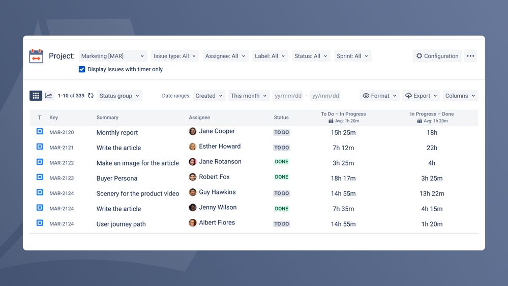

SELECT query from Jira DB is technically possible, but i would like suggest you to try Time in Status for Jira Cloud (developed by my SaaSJet team). With add-on you will get report about Created time, To Do -> In Progress To Deploy -> Done easily. Also add-on haswith 7 types of status time reports
For example The Time in status report shows how long an issue has been spent in each status.Time in status GIF.gif
Also I guess Time Between Statuses will be an option for you. This add-on, which measures connections in the workflow, through a transition time in specific issues. You can count Cycle and Lead Time by setting start/stop and pause statuses in the configuration manager. To detail the calculation conditions you should select the first/last transition to/from status. This add-on developed by my team.
Add-ons have a 30-day free trial version and free up to 10 users.
