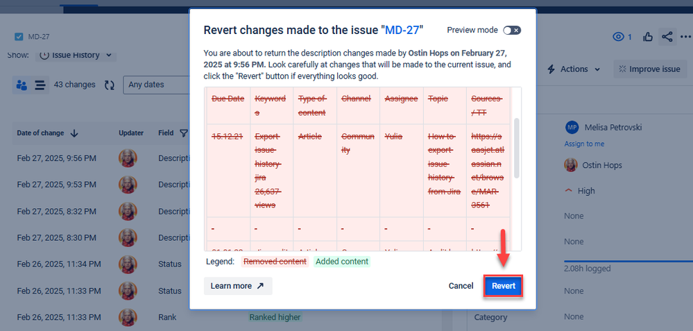

Hi @Laure
If you are open to using add-ons, it's possible to retrieve description content with Issue History for Jira developed by my team. It allows for saving formatting and rolling back changes with few button clicks.
Read about this option here: Revert changes made to the description

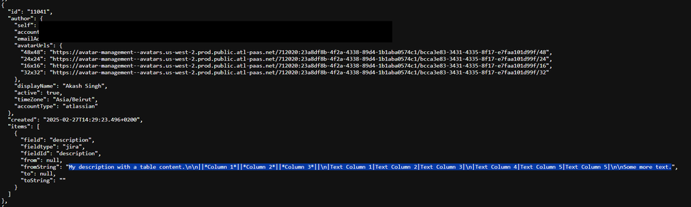

@Laure Welcome to Atlassian Community!
You can recover the description back to its original value by following the below steps,
1. Fetch all the change logs on your issue using following API, you can construct the URL as following,
https://mysite-url.atlassian.net/rest/api/3/issue/<issueKey>/changelog
In the above URL replace the base URL with your instance and change <issueId> with the issue e.g. OS-8 or TP-23.
2. Find the log which describes the change in the Description field and copy the original value from the log as shown in the image below. If the response is incomprehensible for you to read in the browser, I recommend using an online json formatter tool to make it pretty and easy to understand.
