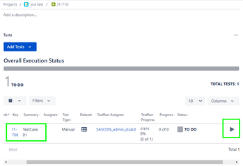

A test execution issue is created. As you can see it contains of a testRun an instance of our recently created test case (see screenshot). This TestRun can now be "run/executed/started with the play button and clicked throug/set to fail/pass"
If you click the play button you will be directed into the TestRun where you can set status of test steps
This is mainly how running tests in XRAY.
