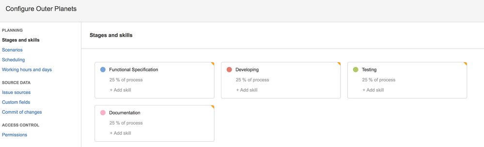

  1. Add these four stages to your Stages in plan configuration.

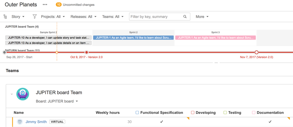

  2. In the Teams panel, check the box for that resource for Functional Specification and Documentation stages.

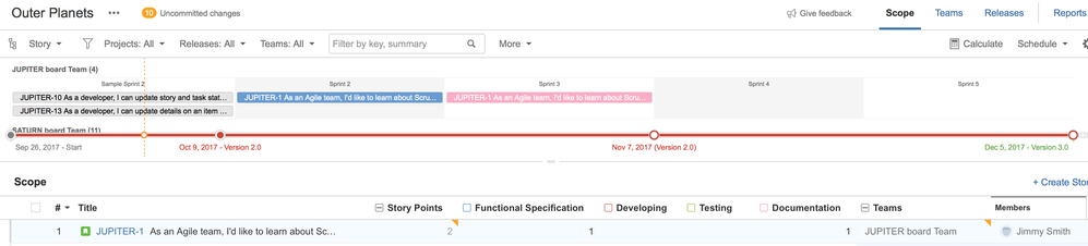

Portfolio won't necessarily tie two stages on the same story to a single resource as you've described when doing auto scheduling / calculations - the idea being you can use excess capacity in your resource pool to fill gaps and accomplish work sooner. For example, if Ann only had enough time left in a sprint to do the Function Specification but not Documentation, another team member with Documentation stage skills and excess capacity could step in and finish the item instead of waiting for the next sprint. Portfolio's calculations try this approach to maximize team efficiency. However you can override by explicitly setting the resource in Scope view.
Ensure Teams and Members are shown in the Scope view (using Gear icon top right of table grid). Then choose a Team, then pick the person from that team explicitly to do the work. That person will then get the points filled in for both stages and your Portfolio plan will be forced to account for that person doing both activities.
It's a bit manual to pick a person for every row, but it will accomplish what you've described here.

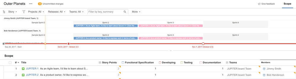

Notice in this screenshot the members are in white background, not blue - meaning they've been explicitly assigned to that row and will have to cover points in both stages.
