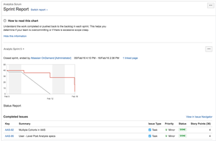

I understand that you would like to see in a report all the hours you estimated for your Sprint against all the effective time you have logged for the issues. Is it correct?
Since both estimation and effectively logged hours are performed per issue which sum is applied to the Sprint, you can track how it is going by using the Sprint report:
  • The grey line is a guideline that's drawn from the total estimate of the issues at the start of the sprint, to 0 at the end of the sprint. The grey line stays flat during non-working days.
  • The red line represents actual work done during the sprint — it's drawn from the total estimate of the issues at the start of the sprint, and it goes higher or lower as your team works on the issues in the sprint. Note that the red line shows the current total estimate for unresolved issues at any point in the sprint. It also reflects issues that are added or removed from the sprint.
