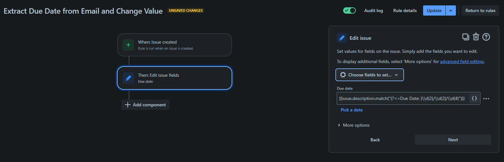

Thank you for the reply Bill! Would you try these in the same contexts? Here's how I had that regex set up previously, with "Due Date" as the selected field obviously.:
In my experience, the only way to know if something works with automation's implementation of regular expressions is experimentation and testing. So try it, and if it works, great!
