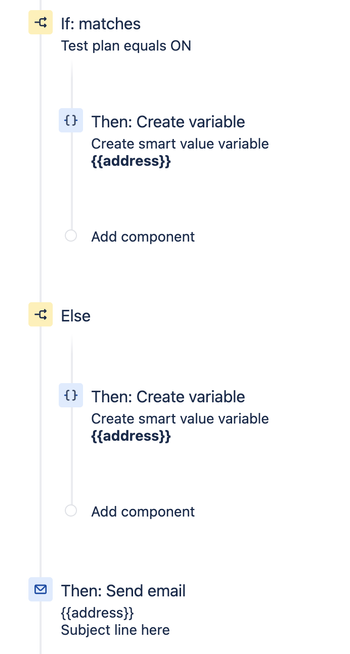

To answer your immediate question, which seems to be "can I use a smart value in the To: field?", the answer is yes. You'll want to create an If/Else block to compare the values of your "TestFlag" field - and then as an action in the if/else, set a variable for the email addresses you want to use. Here's an example of the conditions and actions:

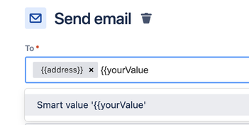

Hint: in the "Send email" action, you can start typing a pair of curly braces and Automation will suggest that the address you're putting in is a smart value:

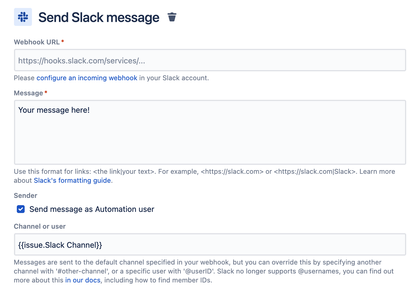

Does your rule strictly need to send an email? Would it be possible to use the "Send Slack message" action instead, which uses webhooks? The formatting of messages coming in through webhooks is significantly cleaner than emails, as well as a little bit faster. An additional advantage is that by using webhooks, you can override the channel the message is going to instead of having to know its email address in advance.
The if/else block logic would still be the same if you used the "Send Slack message" rule instead.
Although theoretically you could have a custom field for the Slack channel name, and then just call that directly as your smart value in the rule.
If you've got a field called "Slack Channel" and have put in a value like #test or #live into the field, you can achieve the same results with one action and no if/else block.

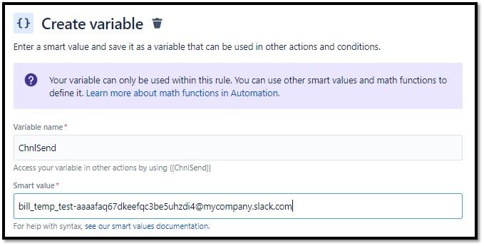

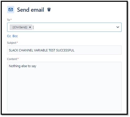

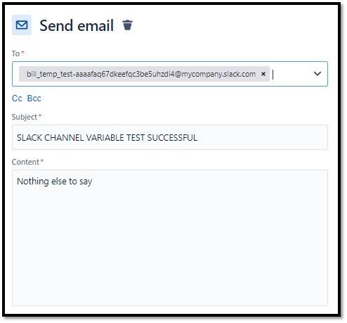

I'm not sure if I was hallucinating or if I actually did get things to work once, but I can't get the variable method to work at all. I create the variable in Picture1, then try to send email using the variable (Picture2), but it doesn't work. I can successfully send email to that slack channel directly (Picture3), so I know the channel works. Going back to Picture1, I've tried this method of setting the variable as shown, I tried putting the address in single quotes, and in double quotes - nothing works.
Any thoughts on what I may be doing wrong?
Hi @Daniel Eads
I think I figured out that there is a bug in how variables are handled. Trying to set the variable by using an If/Else block fails for both conditions, the error in the rule says it's trying to send to an empty address. However, setting the variable and then changing the variable within a simple If condition works for both the original setting and within the If condition when it changes the value. See diagram.
Any thoughts?
Thanks, Bill
Ah, good catch! I believe you're right - I have some rules where the variable is instantiated before setting the variable again inside the block, so that appears to be a critical step I left out for you here. Great troubleshooting!
