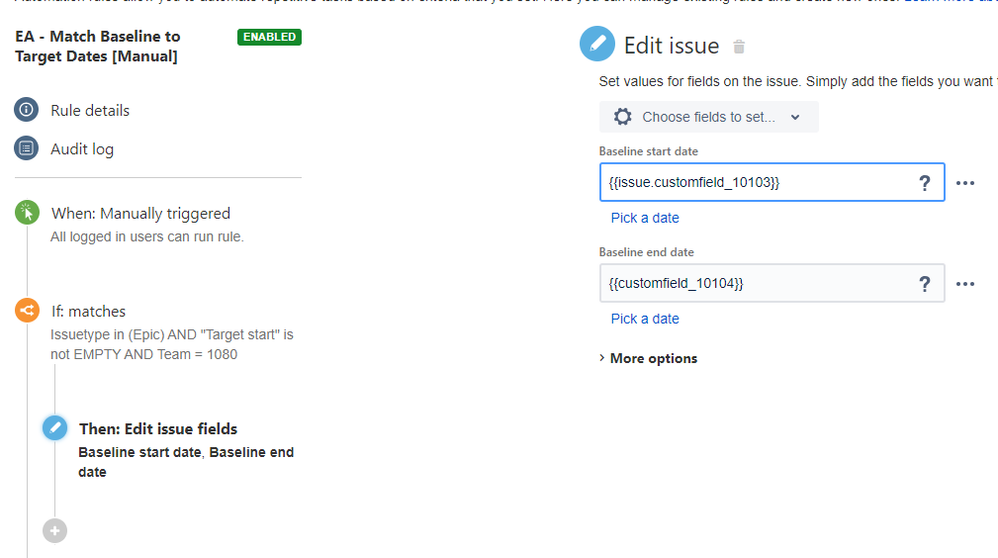

I am trying to create a Manual Automation Rule that would set the Baseline Dates to match Target Dates.
My Rule:
However, I get an Error editing issues

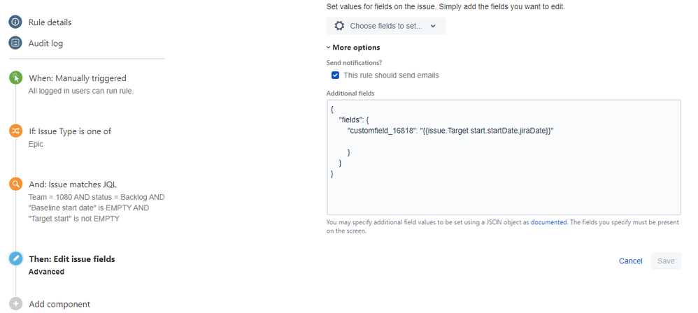

I also tried just using the following in place of the "More Options".
"customfield_16818": "{{issue.Target start.startDate.jiraDate}}"
"Baseline start date": "{{issue.Target start.startDate.jiraDate}}"
"Baseline start date": "{{issue.customfield_10103.startDate.jiraDate}}"

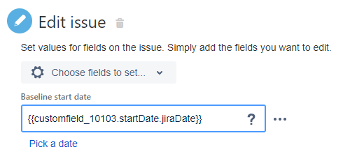

GOT IT!!!
I was definitely overthinking it! This worked.

I don't have those fields in my instance or even comparable ones to test but the JSON may possible be off. Myspacing below maybe off but even the target fields have custom field values so possibly try that
"fields": { "customfield_XXXXX": "{{issue.customfield_YYYYY.jiraDate}}"
I tried that one, too.... that didn't do it. My Baseline start date still did not update sadly. Audit Log says no actions performed.
"fields": { "customfield_16818": "{{issue.customfield_10103.jiraDate}}"
This may not be related to this response, but I also tried using the dropdown and selecting Baseline start date (customfield_16818) and entering the Target start (customfield_10103).
My Audit Log shows success - but the Baseline start date was not updated.
Also tried the following in the Baseline start date field (above) to no avail!
{{Target.startDate.jiraDate}}
{{Target start.startDate.jiraDate}}
Audit Log keeps telling me that my issue was edited successfully...
