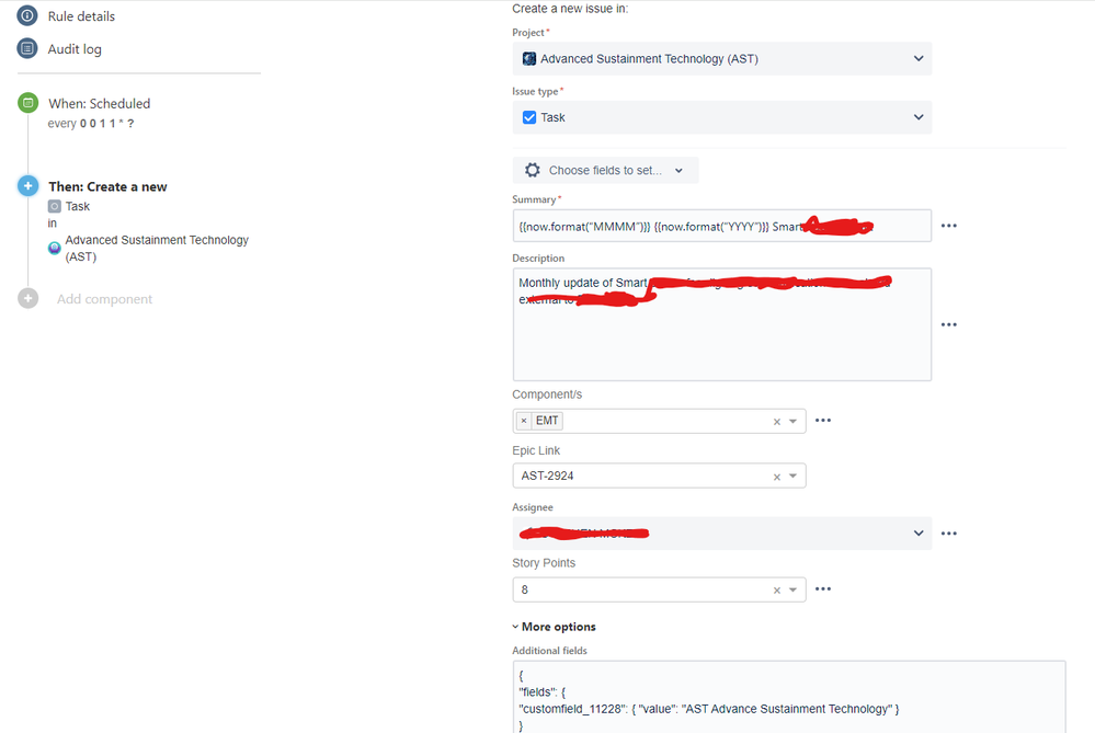

Here is the automation rule:

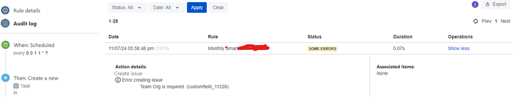

And, here is the error from the Audit Log

Is that field on your create issue screen for that issue type?

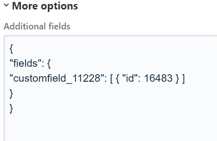

William Tanner July 12, 2024
@Bill Sheboy your help has been fantastic!  Based on your last comment, I was able to identify the ID of the select value: 16483.  I changed my JSON to use the ID and not the "value" and it worked.
For the record, here is the JSON:
