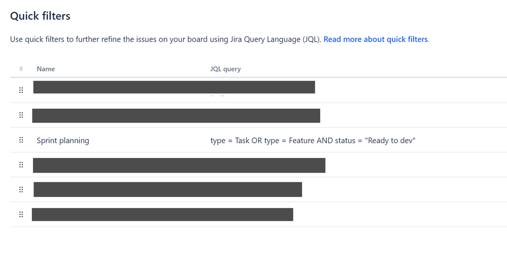

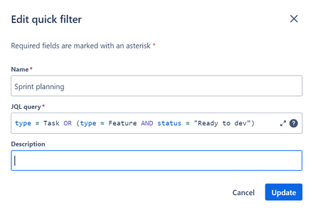

Jan Walsh July 17, 2024
Hi @Hana Kučerová
Unfortunately, I have already tried (and just tried again) the query that you recommended.
Here is a screenshot before I save the Quick Filter:
Here is a screenshot after I click "Update":
As you can see, the parentheses aren't saved. When I open it again, the parentheses aren't there. And, when I refresh my board and use the filter, only tasks appear.
I confirm that I have issues of type "Feature" that should appear and to confirm this even more, a query like this [type = Feature AND status = "Ready to dev"] works to retrieve Feature issues with this status.
