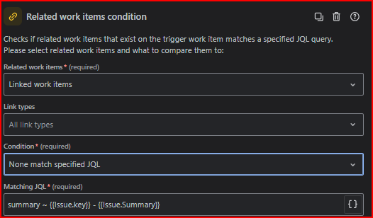

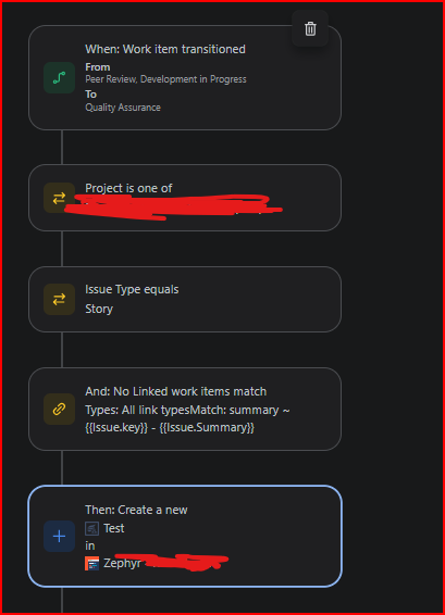

I have a rule automation set up in my project that creates a test ticket in the Zephyr project
I am trying to set it up so if I transition the same statuses again the rule will not create another linked issue if it already exists
New test ticket has the following naming convention for the summary field . The goal of step 4 below is to not create the Zephyr test if there is already a linked ticket
{{Issue.key}} - {{Issue.Summary}}
 Workflow
Step #4

Your JQL is missing "" around the text you want the search for, and I would do a specific search like this:
summary ~ "\"{{issue.key}} - {{issue.summary}}\""
By using "\" \"" the search will only be for that phrase, not any of the words.
Stephen Johnston September 3, 2025
I made that update but it still creates another linked issue

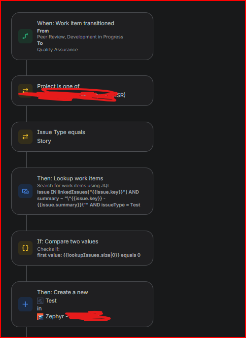

As an alternative building on Mikael's suggested change to the JQL with the exact match syntax, I recommend using the Lookup Work Items action to take better control of the rule steps.  For example, with changes to your rule steps:
  • trigger: work item transitioned...
  • condition: project is one of...
  • condition: issue type equals Story
  • action: lookup work items, with JQL of
issue IN linkedIssues("{{issue.key}}")
AND summary ~ "\"{{issue.key}} - {{issue.summary}}\""
AND issueType = Test
  • smart values condition:
    • first value: {{lookupIssues.size|0}}
    • condition: equals
    • second value: 0
  • action: create a new Test...

It run successfully but it didn't create a Ticket in the Zephyr project
Work item transitioned
09/03/2025, 17:03:55
xxx-63858: Test zephyr new approach
Quality Assurance
Work item fields condition
The following work items passed:
xxx-63858
xxx-63858
Lookup work items
A search during custom value definition found no work items.
{{smart values}} condition
The following work items did not match the condition:
xxx-63858
