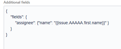

If this still doesn't work can you try a combination of:
assignee: { "key": {{issue.Responsible.first.key}} }
Maybe the docs are confused, or I'm confused, but in any other API it uses keys so I think that might also be a potential thing to look out for.

Radek Dostál
October 8, 2024
Hm, dunno.
These both work though just tried:
or
I'm guessing it's the missing quotes, realized while editing that the smart value returns the "pretty" string without quotes, so you might be probably missing it in your json.
