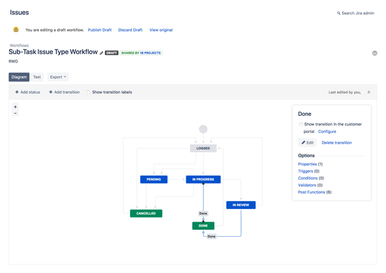

Can you show us a screenshot of the page in jira where you set that opsbar-sequence value? I have seen other users that set this on the status property, instead of setting this on the transition's properties. For this to work, it has to be on the transitions properties instead.
Andrew - for sure ...
Also included a screenshot of the workflow with the transition selected showing that it has 1 property value set.
Pretty sure I've put the property setting in properly, but obviously something isn't working correctly :)
