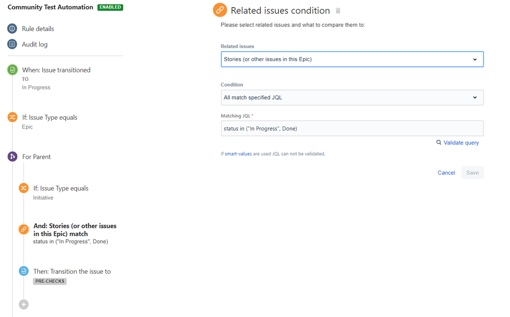

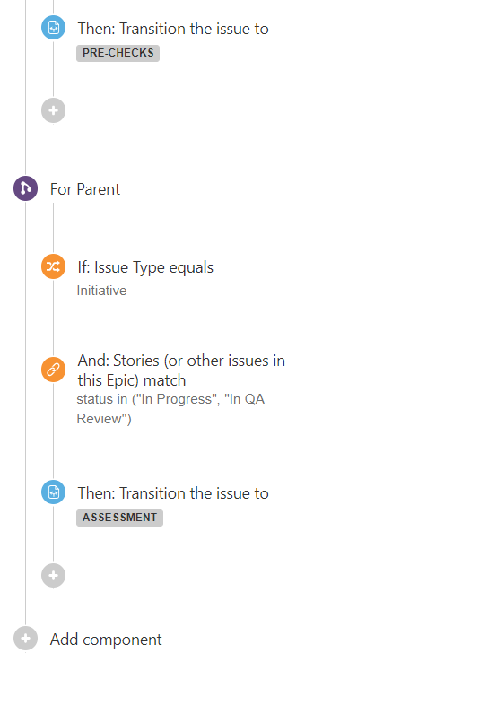

Thanks for clearly explaining your use case and requirements. This should be quite easily achievable using Automation. It might be depending on the version of Jira and/or the Automation plugin for Data Center, but in my 9.12 Jira DC test setup this should work for the In Progress status.
Similarly, you could create a copy of this rule for the Assessment setup, or try to combine it in one automation rule with another Parent branch, like so:

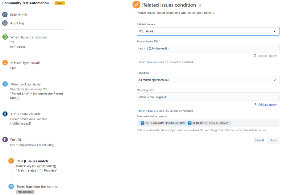

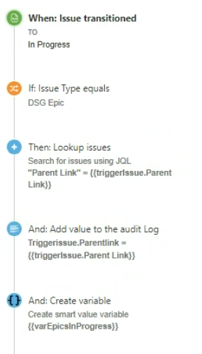

Regardless, I spent quite some time trying to make it work. And I got it to work, but I'm wondering if this is the best solution.
@Bill Sheboy could you please, as Automation Guru, validate and find any improvement opportunities if there are any?
The solution I found:
JQL used in the lookup issues step: "Parent Link" = {{triggerIssue.Parent Link}}
JQL used in the branch: key in ( {{childissues}} )
Keep in mind by the way that the lookupissues function is limited to (I believe) a 100 issues maximum. As long as you don't put more than 100 Epics under a Initiative you should be good to go.

I believe using branch on JQL to access the parent Initiative, then using the Related Issues Condition with JQL could cover each case. But this may potentially lead to some timing / racetrack errors where the Initiative transitions multiple times during the same rule.

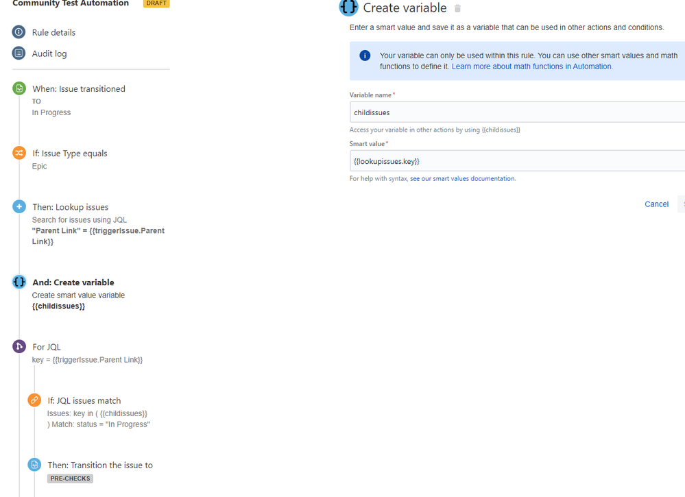

The fix could use what Hans noted with Lookup Issues:
If I was implementing this, I would use Create Variable after the Lookup Issues to first calculate counts for the Epics and their status values. Then use those variables in the condition checks. This would allow writing the variables to the audit log to help with testing / debugging.
For example, the count for epics In-Progress could be this:
{{#=}}0{{#lookupIssues}}{{#if(equals(status.name,"In-Progress"))}}+1{{/}}{{/}}{{/}}

My approach was as follows:

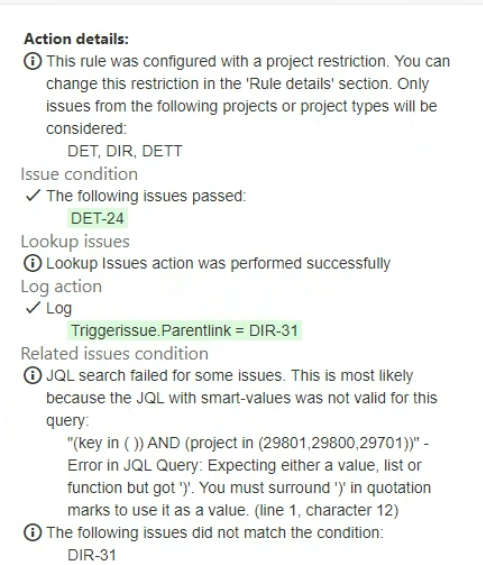

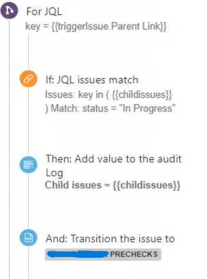

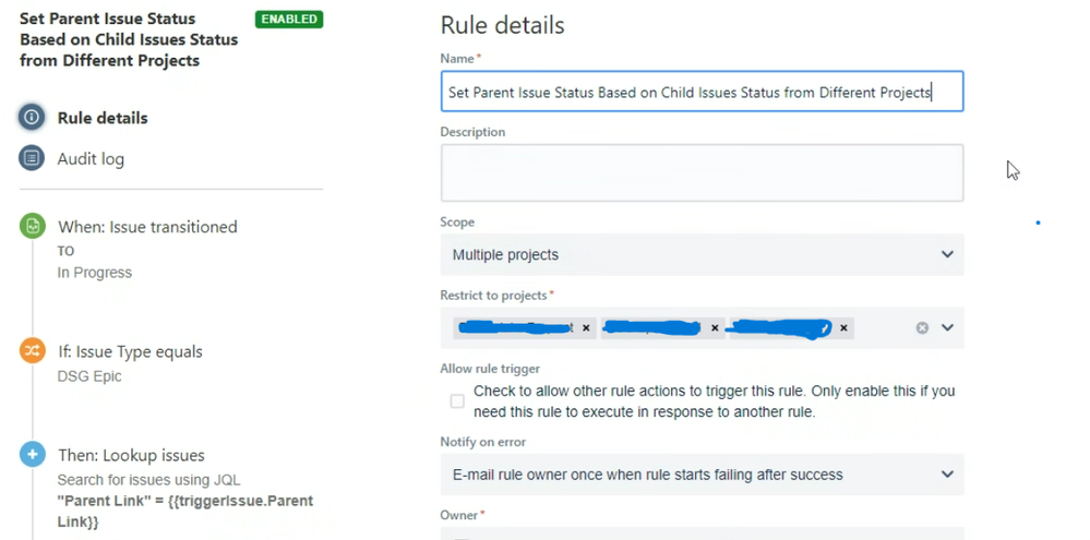

Hi @Hans Polder _Devoteam_ , @Bill Sheboy ,
I would like to share the screenshots of my Rule as requested below:
1) This is Rule details of my Rule:
2) This is the Audit log after configuring Rule and executing the required action:
3) This is the first part of the Rule:
4) This is the second part of the Rule:
I have tried multiple times to configure the rule as per your suggestions but I am unable to see Status update of Parent Issue in Project P based on the Status update of Child Issues in Project C1 and Project C2.
Please guide me further with an appropriate solution.
To help with context, please post an image of the entire rule in one picture and of the entire audit log details showing the rule run in one picture.
You can get those into one image using either an app or a browser extension which supports scrolling page image capture.
Next, if you view the audit log and compare to the rule steps shown {{childissues}} is empty. Where are you getting / setting the value of that smart value?
