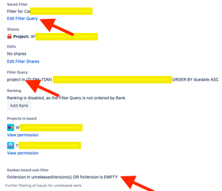

I need sort issues in a Kanban card in an ascending order by resolved date.

Hi Yunusa, welcome to the Atlassian community!
If you are a board administrator you can do one of two things:
  1. Update the filter being used to use "Order By Resolved ASC"
  2. Add to the Order by clause to the boards sub filter
