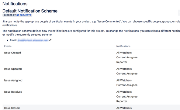

Jack Brickey
April 20, 2018
by default notification exist unless you turn the off. By looking at the notifications for the project it will answer the obvious question. For example here is one I have:
