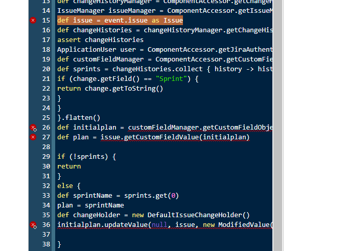

Now I think I have a final version. I will add it hear for anybody else who might search for something similar in the future:
import com.atlassian.jira.issue.MutableIssue
import com.atlassian.jira.issue.Issue
import com.atlassian.jira.issue.IssueManager
import com.atlassian.jira.event.type.EventDispatchOption
import com.atlassian.jira.user.ApplicationUser
import com.atlassian.greenhopper.service.sprint.Sprint
import com.atlassian.jira.issue.customfields.option.LazyLoadedOption
import com.atlassian.jira.issue.ModifiedValue
import com.atlassian.jira.issue.util.DefaultIssueChangeHolder
import com.atlassian.jira.issue.history.ChangeItemBean
def changeHistoryManager = ComponentAccessor.getChangeHistoryManager()
IssueManager issueManager = ComponentAccessor.getIssueManager()
def issue = event.issue as Issue
def changeHistories = changeHistoryManager.getChangeHistories(issue)
assert changeHistories
ApplicationUser user = ComponentAccessor.getJiraAuthenticationContext().getLoggedInUser()
def customFieldManager = ComponentAccessor.getCustomFieldManager()
def sprints = changeHistories.collect { history -> history.getChangeItemBeans().findResults { ChangeItemBean change ->
if (change.getField() == "Sprint") {
return change.getToString()
}.flatten()
def initialplan = customFieldManager.getCustomFieldObjects(event.issue).find {it.name == "Initial Sprint Planned"}
def plan = issue.getCustomFieldValue(initialplan)
if (!sprints) {
return
else {
def sprintName = sprints.get(0)
plan = sprintName
def changeHolder = new DefaultIssueChangeHolder()
initialplan.updateValue(null, issue, new ModifiedValue(issue.getCustomFieldValue(initialplan), plan),changeHolder)
This works for us:
}.flatten()
if (!sprints) {
return
else {
plan = sprintName
