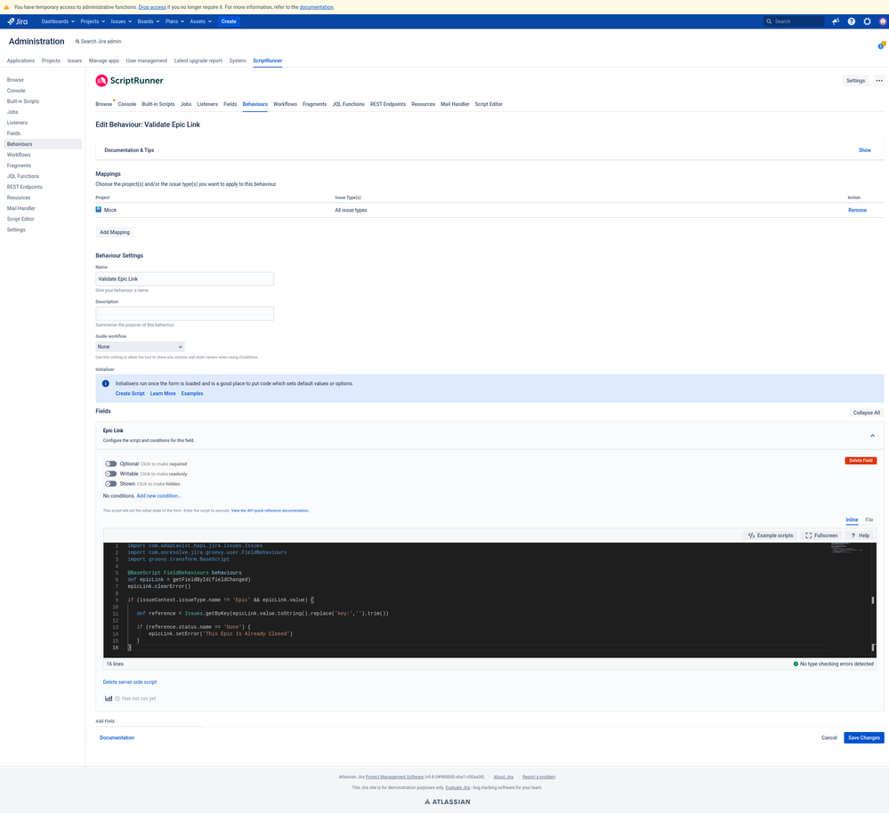

Below is a screenshot of the Behaviour configuration:-

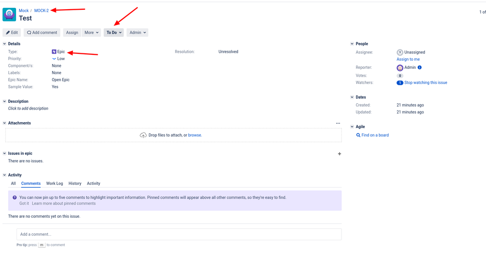

1. The test will be performed using 2 Epic issues, i.e. MOCK-1 and MOCK-2 as shown in the screenshots below. The MOCK-1 Epic status is Done, and the MOCK-2 Epic status is in To Do status.
The MOCK-1 Epic Name is Sample Epic and MOCK-2's Epic Name is Open Epic.

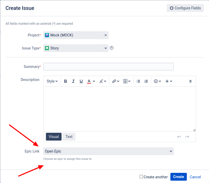

2. Next, I will try and create a new Story and link it to MOCK-1 Epic which is in the Done status. As expected, the Epic Link returns an error message as shown in the screenshot below.
3. Finally, I will try to link the Story to MOCK-2, i.e. the Epic which is in the To Do status. As expected, the Epic Link field is not returning any error as shown in the screenshot below:-

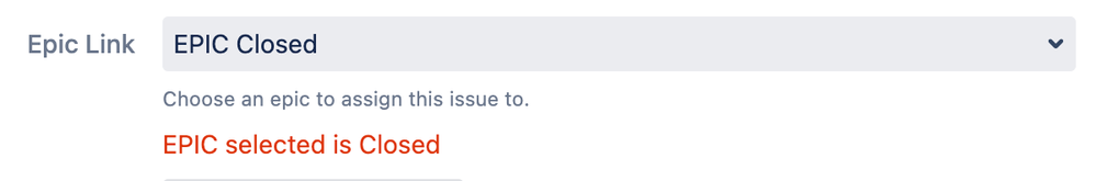

Hi @Likhita , I'm not sure if it can be done natively for Jira Data Center, but if you have ScriptRunner for Jira Data Center, then it is definitely possible with the workflows validator.
You can use a simple scripted validator with this sample (ScriptRunner Jira DC - Workflow Validator (If Epic link/parent selected is in status "Done", block issue creation) ). This may not be 100% the same in your instance.
I made it to show me the error under the epic link custom field.
