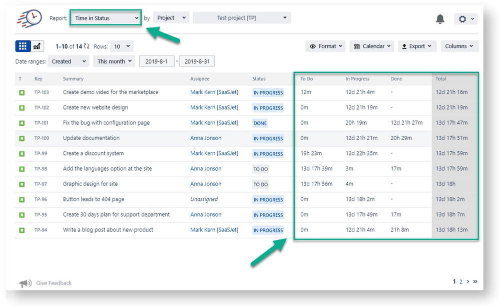

As an alternative, you can try Time in Status for Jira Cloud. It's developed by my team specifically for easy tracking of how long an issue has been in from one specific status to another specific status and analysis of critical moments.
In addition to the Time in Status report, you can also analyze:
Or use a Pivot Table to customize your report.
Here is an online demo link, you can try an add-on without installing it.
Hope it helps.

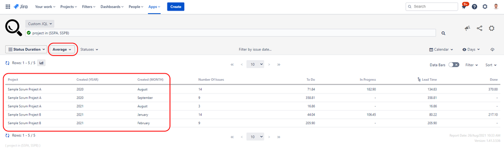

Hi @SHEHZADALI ISMAILY ,
Unfortunately, what you are looking for is not possible with the built-in functionalities of JQL. Because JQL can not make calculations and you need status time calculation.
For this exact need we developed Status Time Jira app. It provides reports on how much time passed in each status. By grouping statuses you can get cycle time(E.g from in progress status to done status). You can also export the report as CSV and open it in excel.
Once you enter your working calendar into the app, it takes your working schedule into account too. That is, "In Progress" time of an issue opened on Friday at 5 PM and closed on Monday at 9 AM, will be a few hours rather than 3 days. It has various other reports like assignee time, status entry dates, average/sum reports by any field(e.g. average in progress time by project, average cycle time by issue creation month). And all these are available as gadgets on the dashboard too.
Here is the online demo link, you can see it in action and try without installing the app.
If you are looking for a free solution, you can try the limited version Status Time Free. Hope it helps.
