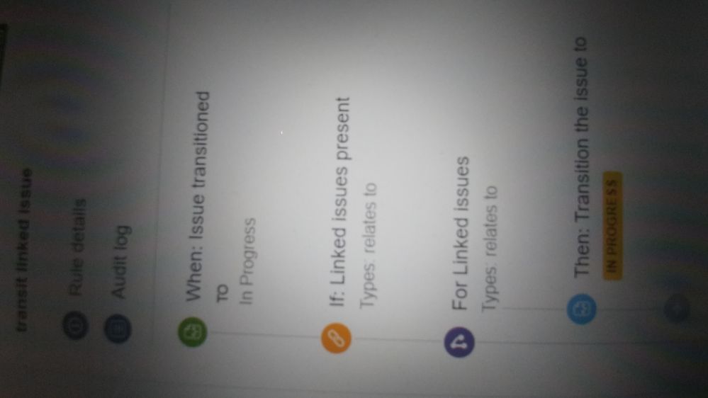

I checked my automation i it works fine. I will send you my automation (excuse me my computer have problem) ( you can subtitute your type of links or add more condition)
Did you try to transition issues from different projects that the one that goes as source of the trigger? The thing is automation doesnt allow to execute more than 500 global actions per month. And if I make that automation rule for project only it doesnt see the issues of another project so it cant transition it.
No, it is just for 1 project. So why don't you use add-ons like (workflow powerbox, Jira misc workflow extension, JSU Automation Suite for Jira Workflows)? They all have your solutions on workflow
