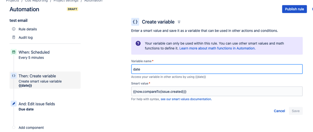

I created a variable in the automation like this
this function should be a number, then I called it to modify the due Date

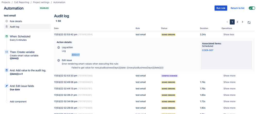

I got this error
Does anyone know what is happening here?

I added the log action, but the same error is still here

Your change to the variable renders my last comment moot. Looking at the log, it looks like your date variable now returns 300 (at least on your test issue).  I'm not sure why you added ">=1" to your log entry though.  Is 300 what you're hoping to get from that diff?
juan_lara March 17, 2022
@Mark Segall that 300>= 1 was my mistake but is fixed now.  the problem is when I call the {{date}} inside {{now.plusDays({{date}})}}
that is the problem, I don't know if inside this function I need to use a different way to call the variable?
