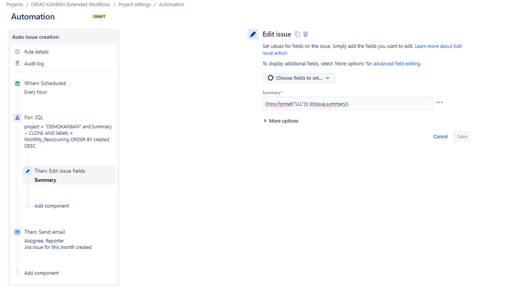

Apologies for the additional message however, this doesn't appear to be working, as I am not seeing any change on editing the Summary field, no error received either.
Trudy Claspill
August 29, 2023
Please show us your complete automation rule and the details of the step where you are changing the Summary field.

You have a typo in the smart value.
You have an extra "s" in there. Also the "i" needs to be lower case.

Here is the Edit Issue step, also here is the Activity screenshot from the change completed by the Automation step.  Because the initial example was getting confusing with the "CLONE" text in the Summary I moved to another issue I was testing with, so the summary content is slightly different.  But the result is still the same.

Trudy Claspill
August 29, 2023
In your smart value it looks like you have a space between {{issue. and summary}}
If that is the case, that explains the problem. You need to remove that space.
Smart values can be very sensitive. You need to make sure you are using the right case, and have spaced only where they are supposed to be.

Thank you for your support and patience.  This is working as expected.
