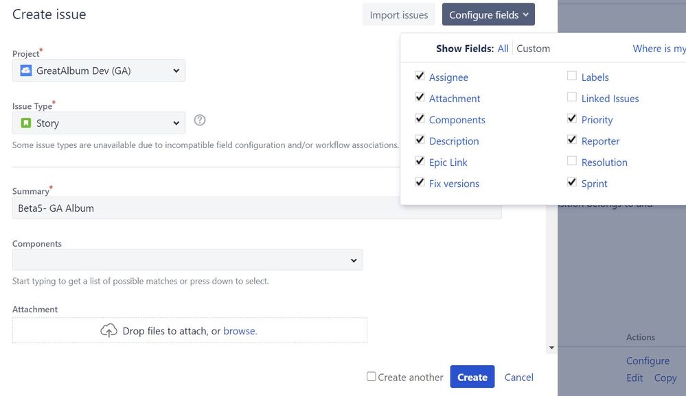

As you can see, I have removed(unchecked) the resolution field while creating a new story/issue.
Once i complete creating a new story by clicking the "create" button,  Automatically resolution field pops us as an error as shown below.
Even though i tried removing the Resolution field from the Create screen,  why does the resolution field still pop up? Any suggestions?

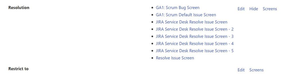

I Checked the Field Configurations file for that project. please find the below screen shot.
I don't see the optional button, can i try the hide option?

Hi @John Funk
I tried the hide option from the "filed configuration" page, It worked.
Now i don't see resolution field pop up as an error while creating a new story/issue.

Yes, sorry - meant to tell you to do the Hide on that field since it is a System field.
Glad it is working for you.  :-)
