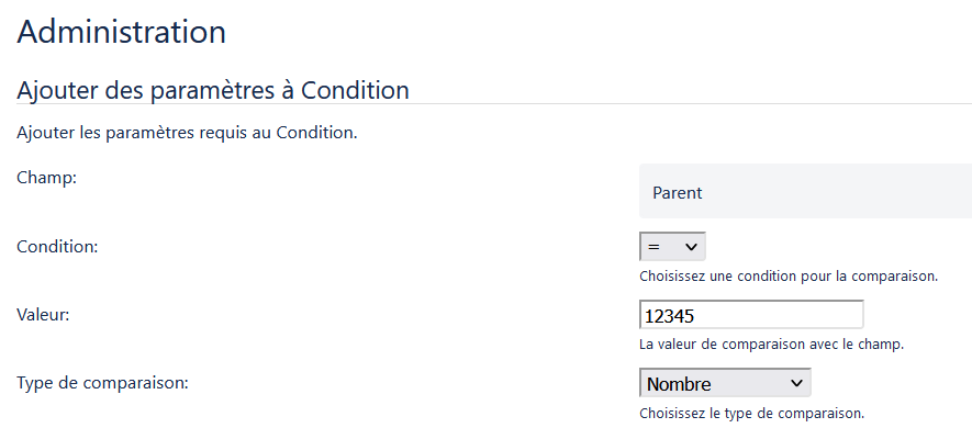

I'm struggling to get the workflow condition, value field, for the field parent working.
My purpose: I want to allow a workflow transition only if my issue has a specific parent.
I tried to set different Value Field conditions on my transition, but none worked.
None of these conditions let my issue with parent 12345 transition to my status.
I guess I'm doing something wrong, but I can't see what.
Could you help me ?
Thanks in advance, have a nice day
Clément

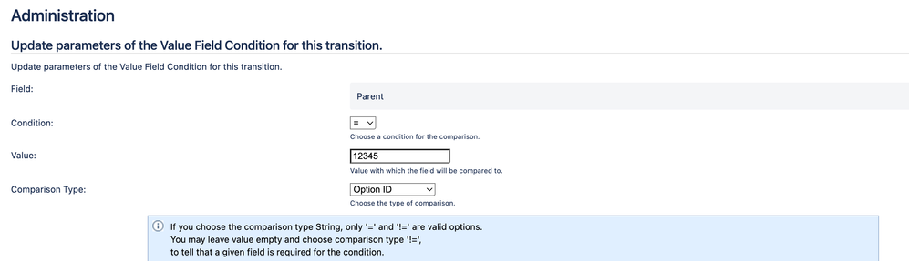

I tried also with OptionID, does not work ether.
