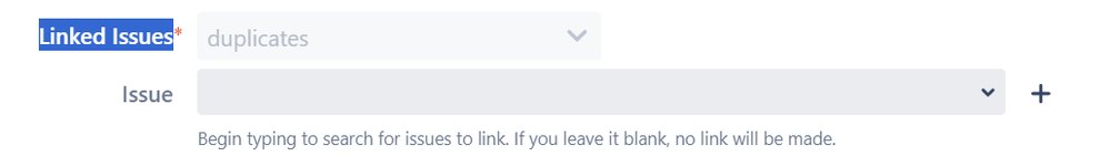

Hi all,
We have transition called duplicate when use clicks it window opens with field Linked Issue then  user choose as duplicate value then we will have another field call Issue (issue searchable field ) for this field how we write validator or scriptrunner script to validate that enter key is bug type then only transition otherwise through error massage (refer attached screenshot for more)

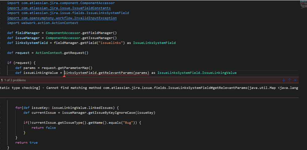

Thank you for the such valuable support. kindly help me to sort error after pasting above code into Simple scripted validator as below
on line
def issueLinkingValue = linksSystemField.getRelevantParams(params) as IssueLinksSystemField.IssueLinkingValue
getting below error: [Static type checking] - Cannot find matching method com.atlassian.jira.issue.fields.IssueLinksSystemField#getRelevantParams(java.util.Map <java.lang.String, [Ljava.lang.String;>). Please check if the declared type is correct and if the method exists.
Also, refer attached screen shot for complete error

Adrien Low _ServiceRocket_
November 20, 2023
Hello @Dayanand ,
You can probably ignore that error message. I have the same behavior on my end. Try saving the configuration and give it a go.
Regards.
