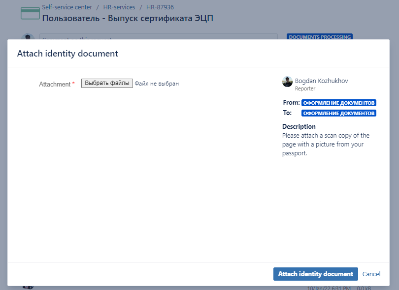

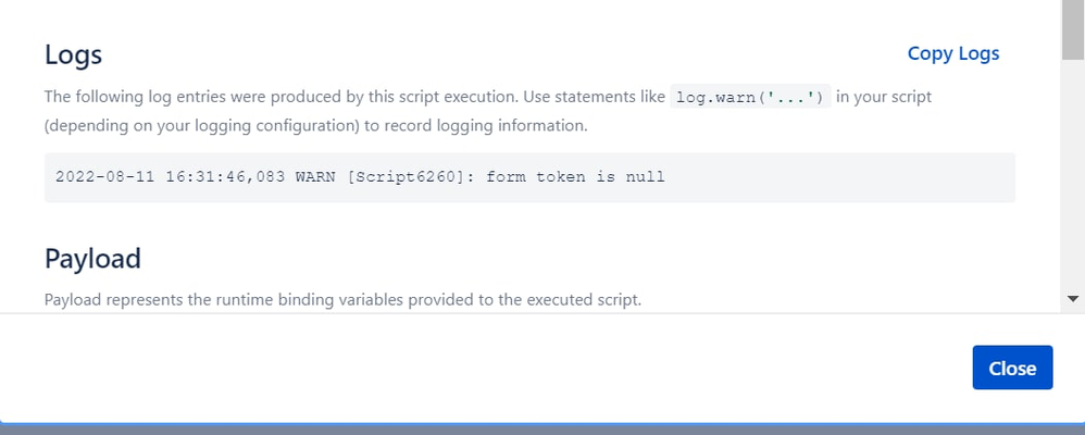

I'm trying to validate the number of attachments in a transition. You can get temporary attachments through form token or id temporary attachment. I am trying to access temporary attachments via form token, because I haven't found a way to get ids temporary attachments. As a result, validation only works for Jira. If you make the transition through plugin Actions for JIRA Service Desk from Customer Portal - validation fails, because form token is null and I can't get access to temporary attachments.
How do I solve the attachment validation problem by number on Customer Poral page? How can I get form token?

  log.warn('form token is null')

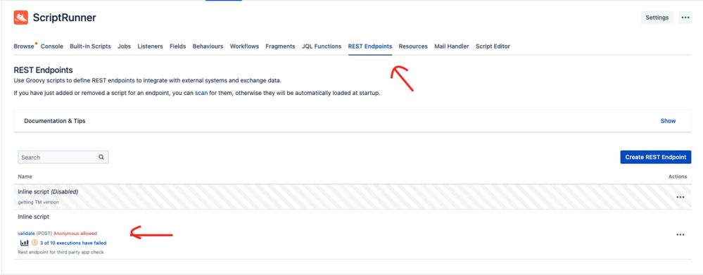

You are required to create a REST Endpoint in the script runner, as shown in the screenshot below:

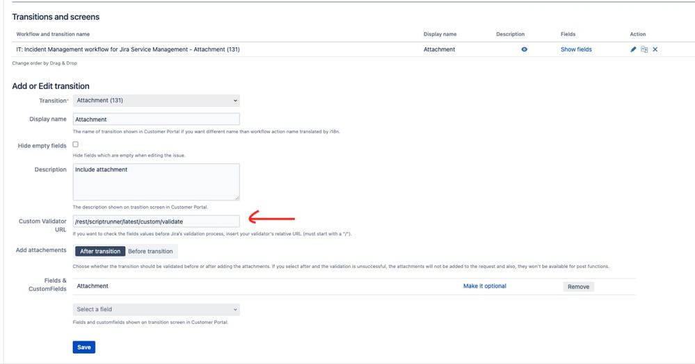

2. After the REST Endpoint is created, you will use the link mentioned in the documentation and configure it accordingly, as shown in the screenshot below:

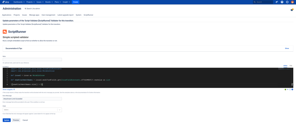

Could you please try to modify the code provided in the Adaptavist Library to this:-
import com.atlassian.jira.issue.IssueFieldConstants
import com.atlassian.jira.issue.MutableIssue
def issue2 = issue as MutableIssue
def newAttachmentNames = issue2.modifiedFields.get(IssueFieldConstants.ATTACHMENT)?.newValue as List
!(newAttachmentNames.size() > 5)
Below is a screenshot of the validator configuration:-

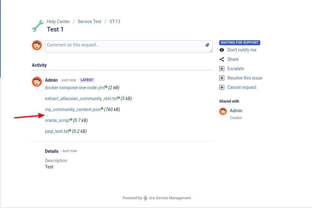

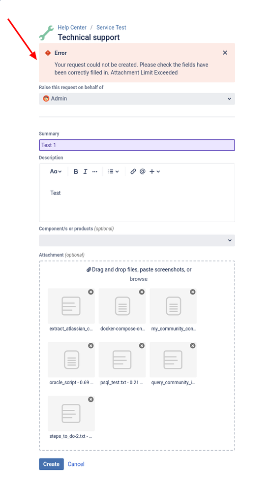

1) First, when I try to create a technical support ticket, I try to enter 7 attachments. The maximum number of attachments has been set to 5. As expected, when I try to create the issue, the validator returns an error message.
2) When I remove the attachments to the max limit of 5, I can now create the ticket as shown below:-image2.png

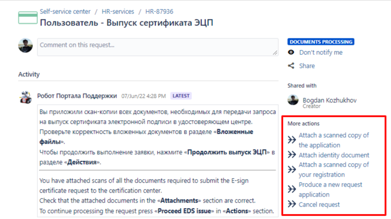

Toolstrek, LLC August 22, 2022
Hi, @Ram Kumar Aravindakshan _Adaptavist_
Plugin Actions for Jira Service Desk allows you to make transitions on a customer portal.
image.pngBut but the validation of attachments on these transitions for some reason still does not work.
Cheers, Bogdan
