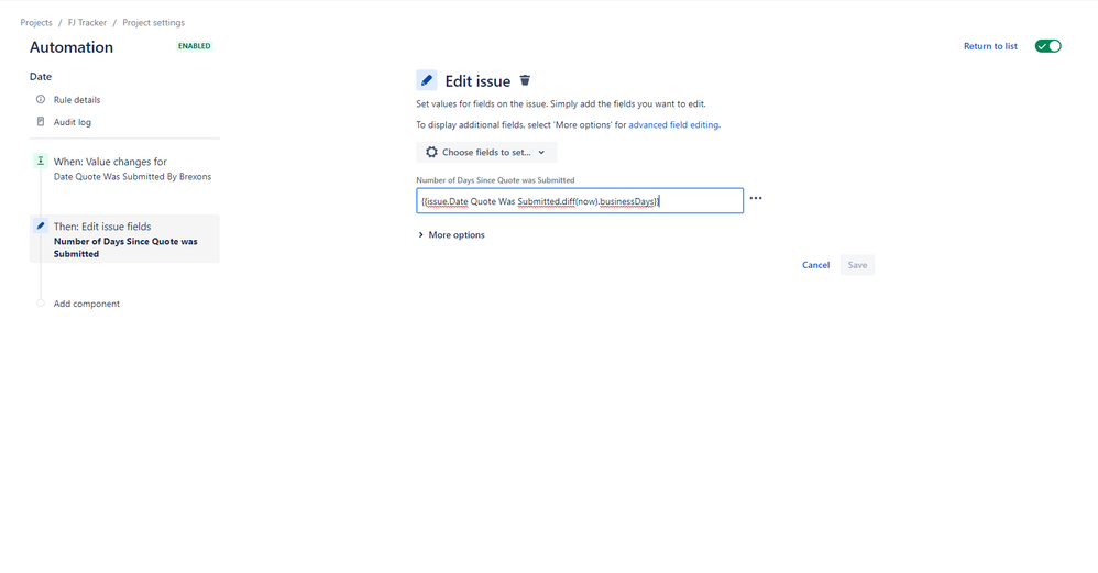

Thank you both for your response.
Sorry I am new to this. To achieve this would I need to create another custom field for the number of days to go into?
Further more, which trigger would be the best one to use when creating the automation rule and then for the action would it be "Comment on Issue"
Again thank you both for your help and sorry to be a pain.

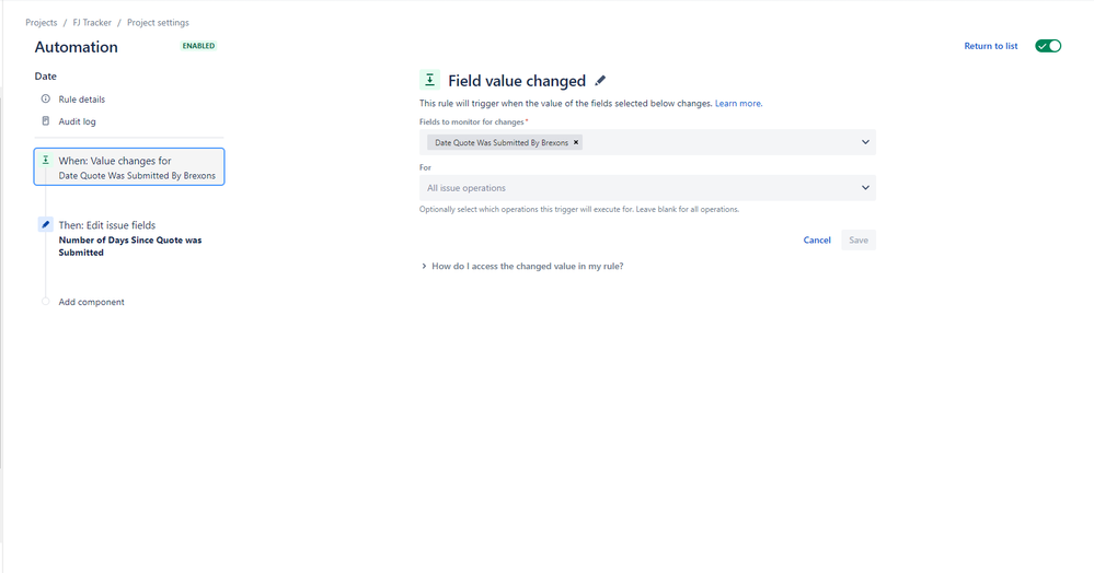

What do you want to do with that value for the number of days? For example, if you wanted to report/filter on it, you could calculate it with an automation rule and then store it in another custom field.
Regarding the rule trigger, you could check on a change to your "Date Quote Was Submitted" field, such as:

Hi @Bill Sheboy
Yeah we are wanting it to report on. We are using this to track to see how long the quote has been submitted for since being submitted as we will use this information to track our 75 Day quote period.
The second custom field which is called "Number of Days Since Quote was Submitted". I have done this as a numbers field due to it just requiring a number in there.
I have attempted the automation rule and its run successfully however it doesn't fill in the empty custom field. Is there something I am doing incorrectly.
Matthew, I think you may have the incorrect name of the smart value for your field in the edit expression.
Please use this how-to article to find the exact smart value for your field: https://support.atlassian.com/cloud-automation/docs/find-the-smart-value-for-a-field/
Basically you find an example issue with your field, and then call the REST API from a browser tab. That will show you what to use in the rule.
Thank you, I have managed to get this working now thanks to your help. Really appreciated.
