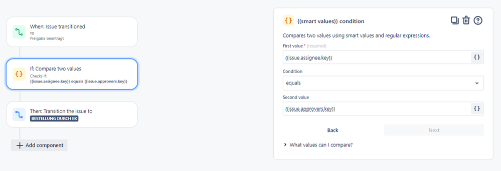

Hello @Tugba Capaci
"key" is not a documented attribute of a user field, as per
https://support.atlassian.com/cloud-automation/docs/jira-smart-values-users/
Did you test this and find that it actually works?

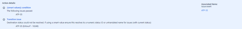

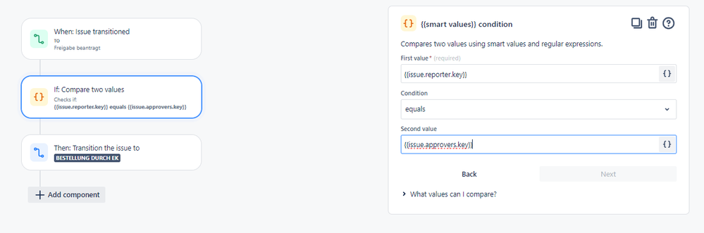

Hello @Trudy Claspill ,
I shared this workflow as a showcase for giving an opinion about the workflow basics.
Now, I tried to run this, and you're right, "key" is not necessary. I wrote it according to the placeholder on the "First value" field.

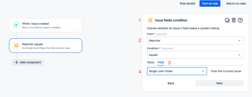

The general structure provided by @Tugba Capaci is correct, except for the Condition suggested.
You can use an Issue Fields Condition (1) to compare the value of one field to another field of the same field type.
Pick Reporter for one field (2).
By default the second part of the comparison will the set to Value. Click instead on Field (3).
Then you can select the Approver field (4). I don't have an Approver field so I specified another field.

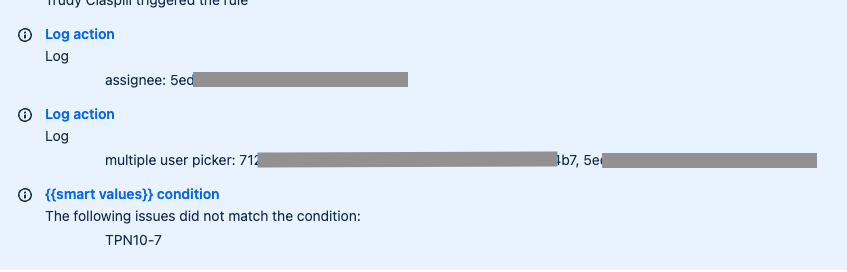

I had this solution but unfortunately I could not select Approvers. Approvers is Multi-User Customfield. Maybe that's why it didn't work.
I think you are correct. It looks like if the first field you specify is a single user picker field (i.e. Assignee) then you can compare it only to other single user picker fields. Likewise if the first field you specify is a multiple user picker field (i.e. Approvers) then you can compare it only to other multiple user picker fields.
